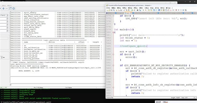

    During full-device testing, we observed that two devices encounter the MPSL ASSERT: 1, 1519 error after approximately one hour of operation, which causes the MCU to reboot. In addition, several other devices experience the same error about once per day, while the majority of devices operate normally.
    We have confirmed that this is related to an HF crystal oscillator startup timeout. We would like to confirm the timeout duration and the number of retry attempts for the crystal startup.
The main MCU is nRF54L15, using SDK v3.1.0.

  • Hmm, that seems high. Are you sure that your firmware is not disabling global interrupts at any part or time in your code? The assert says that the app somehow kept the CPU for itself a bit longer than it should. Are you using timeslot API? if yes, did you receive MPSL_TIMESLOT_SIGNAL_OVERSTAYED event before the assert?
  • After extensive cross-testing, we have concluded that this is not a software logic issue but rather related to the crystal oscillator startup time. The specific problem we need to confirm is as follows:
    Currently, we have set CONFIG_MPSL_HFCLK_LATENCY to 1800 µs, while the actual measured crystal oscillator startup time is around 1000 µs. In theory, this configuration should not trigger an assertion; however, in practice, the assertion still occurs.
    We therefore suspect that the timeout used to trigger the assertion is effectively 1000 µs instead of the configured CONFIG_MPSL_HFCLK_LATENCY value. We would like the Nordic team to review the MPSL source code to confirm this behavior.
