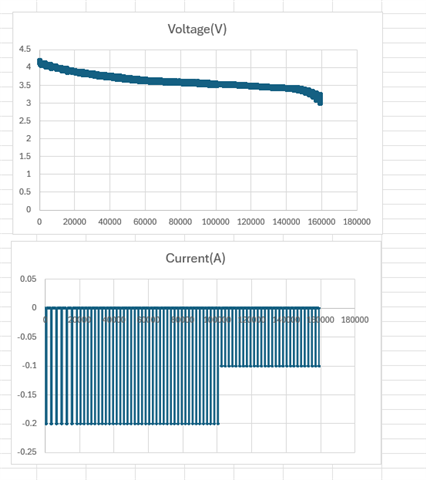

I have profiled a battery following the instruction of this link nPM1300 EK - Get started - nordicsemi.com .
Since I cannot use the battery NTC, I have placed a jumper between the NTC pin and the 10kOhm one on the nPM1300EK.
After the profiling, I have checked the current and voltage measurements and I have noticed that during the discharge the current is not constant, but pulsed (as shown in the picture).
I would like to know if this is normal or not.
