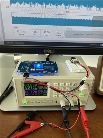

I'm using the Power Profiler Kit II to measure current draw of an ESP32 board at idle. The PPK2 is connected to the battery terminals of the board (XIAO ESP32-S3)  and whether it's set to source meter or ampere meter, when the voltage is at 3.55V it shows a current draw of about 300mA. When the voltage is set to 3.4v or 3.7v it shows the correct draw of 36mA (As verified with a Fluke digital multimeter).
When nothing is attached to the board this issue happens around 3.55V, but with some components attached it happens around 3.7V, so it doesn't always happen around the same voltage. I did try another XIAO ESP32-S3 board with the same result.
Is there something I need to do differently? With the same exact circuit, other meters show the correct current no matter what the voltage.
