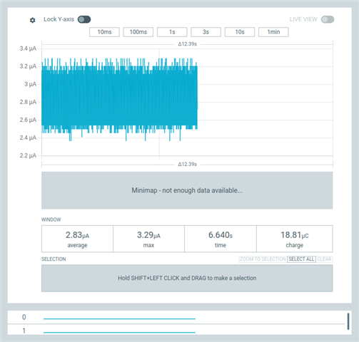

just got my PPK2 and noticed some strange behavior:

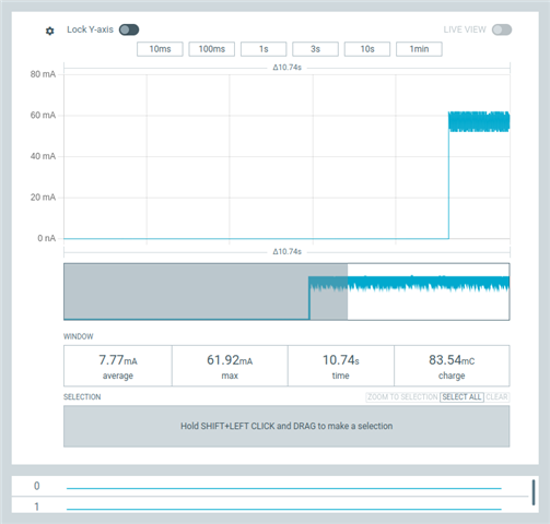

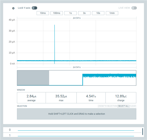

the only thing connected is USB data/power, no DUT. Power output is off. If you start logging it displays some micro amps (pic 1). Turning power on you see a brief spike (pic 2) but after turning power off again it jumps to 60 mAmps (pic 3) and stays there even after stopping and starting to log again. This also happens if a DUT is connected.
The micro amps will only be displayed after turning on the PPK2 after turning on/off power it will stay at those 60 mAmps. Disconnecting / connecting the PPK2 won't change that.
The software version is 4.3.1
What's going on?

  • Hi Swathy. Just wanted to let you know that I was able to get RP a replacement PPK2, and he confirmed that it is functioning and producing reliable results. Cheers, Robb
