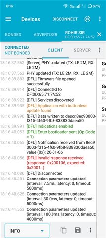

I am using SDK version 17.0.1 and have implemented OTA. I have also implemented a buttonless DFU without bonding and created a Blinky application. However, when I try to upload the ZIP file, I get the following error:
Enter bootloader sent (Op Code = 1)
Notification received from 8ec90003-f315-4f60-9fb8-838830daea50, value (0x): 20-01-06
Invalid response received (response: 0x200106, expected: 0x2001..)
All required configurations are enabled, such as DFU_ENABLE = 1.
Buttonless support is set to 0.

A 18:04:16.121 [DFU] Enter bootloader sent (Op Code = 1)
I 18:04:16.121 [DFU] Notification received from 8ec90003-f315-4f60-9fb8-838830daea50, value (0x): 20-01-06
E 18:04:16.121 [DFU] Invalid response received (response: 0x200106, expected: 0x2001..)

    The app is responding with DFU_RSP_BUSY in response to the DFU enter command. Does your app run ble_dfu_buttonless_async_svci_init() at the beginning of main() like the ble_app_buttonless sample as well?

  • Actually, I am not using the buttonless sample code. I am using the Blinky application, and that error is coming. Can you first correct this using the sample code?
  • Yes, I know you are working on integrating the buttonless support into the Blinky sample, but I don’t have enough information to determine why you are getting the busy error in your case. That’s why as part of the troubleshooting asked if you could try the same with the reference implementation as well as trying to debug your app.
  • Since the Blinky application was not working, I used the Buttonless DFU application. However, I am still encountering the same issue. I will provide the commands used and the nRF Connect logs for reference.

  • I have not been able to find any other reports of this issue, nor have I experienced it myself. I see you changed the device name, did you change anything else in the original example apart from this? Please also attempt to debug the app to see where the busy error is being returned.
