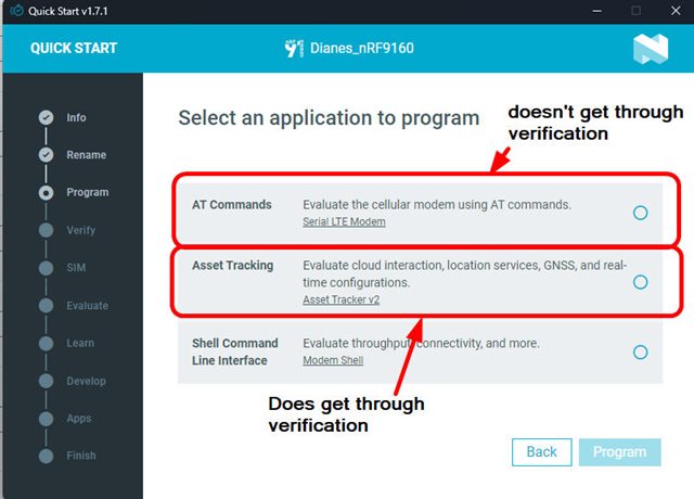

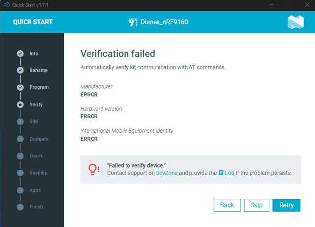

I just ordered and opened up the nRF9160 dev kit from Digikey.  I was going through the quick start and I named the device and when I went through the verification step, it failed.  I've attached a screen snapshot and the log it generated.  Why is this?

2026-01-25T16:20:28.439Z DEBUG Changed step: Verify
2026-01-25T16:20:31.449Z INFO Opened port with options: {"path":"COM4","baudRate":115200}
2026-01-25T16:20:33.457Z ERROR Received ERROR as return value from AT command
2026-01-25T16:20:33.464Z INFO Closed port: COM4
2026-01-25T16:23:45.945Z INFO Opened port with options: {"path":"COM4","baudRate":115200}
2026-01-25T16:23:47.946Z ERROR Received ERROR as return value from AT command
2026-01-25T16:23:47.955Z INFO Closed port: COM4

    I was apparently mistaken, the bug didn't come from the .hex file, It comes from a bug in the On-Board Firmware from J-Link. It has been fixed in recent versions.
    It is possible to solve the issue by updating the OB FW of your nRF9160 DK. Here is the documentation from SEGGER on how to update it.
    I would recommend you going with the latest J-Link version v9.14a. You can download it here.
