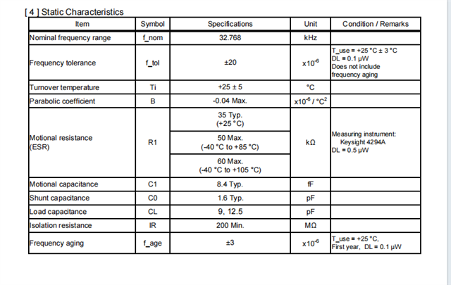

  • Drift of 2.5 seconds/day is about 30PPM, you cannot measure a crystal this precise with just an oscilloscope.
    What is the actual spec of your LFXO crystal according to the datasheet? Maybe your loading caps are a tiny bit off.
    As  has already noted, 30 PPM is quite good and may need good equipment for accurately measuring that. However if you ran a test for a day and then compared the clock, then I would not doubt your measurements.

  • For a 32.768kHz crystal oscillator, 30ppm is approximately 1Hz. The oscilloscope we use can display frequency with 4 decimal places, so this should be able to show the difference, right? If not, how should we know if the load capacitance is appropriate?
    This is part of the parameters of a 32.768kHz crystal oscillator. According to this CL value, the load capacitance should be in the range of several pF, but when we measure the crystal oscillator frequency with an oscilloscope, the actual frequency is most accurate with a load capacitance of 20 or 22pF.
