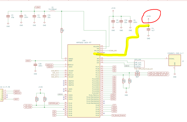

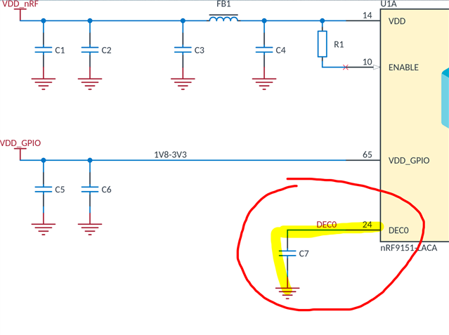

Its a custom PCB and closely follows the schematic of the nrf9151 DK.

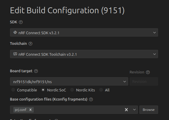

For first test SW we’re using the AT-Commander example and added our own overlay.

    Did you have a chance to check the schematic?
