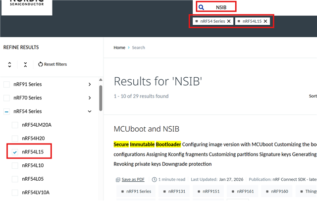

This is just a request for an update to some documentation.
If you do a web search for "nrf NSIB" the first page this is likely to show up is this one. It's a good page and gives a great overview on NSIB OTP and other core info.
There is some basic info on building, just enough that someone might work it out. Doing some more basic research for NSIB + MCUboot you will find this page, another good page with better build instructions.
