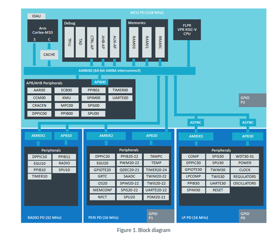

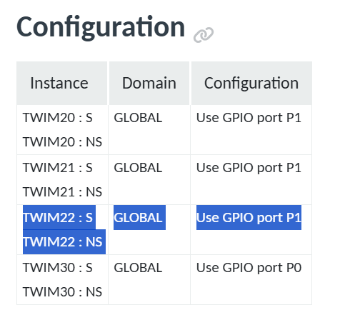

  • Hello Jade,
    You are welcome.
    ''Using another twim, it isn't possible that the I2C communication works with this pinout configuration ?''
    It is not possible to use Port2 for TWIM on nRF54L15. The hardware simply does not route any TWIM instance to port2. You can look at this block diagram
    This means that TWIM20-TWIM22 can be assigned pins on GPIO port P1, TWIM30 can be assigned pins on GPIO port P0.
