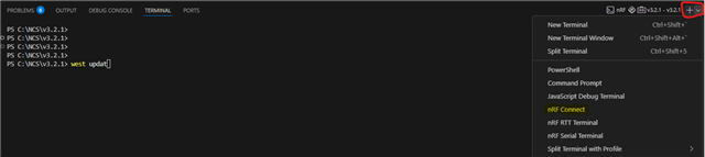

  • Could you run "west update" under C:\NCS\v3.2.1? Let me know wether it can help or not.
  • PS C:\ncs\v3.2.1> west update
      File "C:\ncs\toolchains\66cdf9b75e\opt\bin\Scripts\west.exe", line 1
    SyntaxError: Non-UTF-8 code starting with '\x90' in file C:\ncs\toolchains\66cdf9b75e\opt\bin\Scripts\west.exe on line 1, but no encoding declared; see python.org/.../ for details
    PS C:\ncs\v3.2.1>
  • Please provide the support information from the Welcome View.
