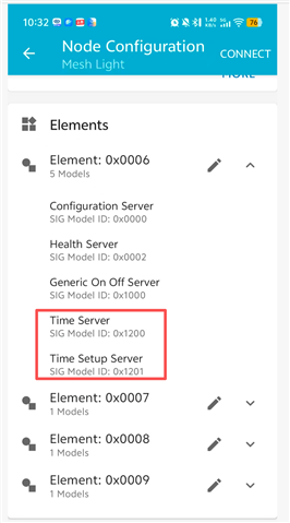

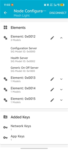

2.customer need new function in the light and add new model(time model), and upgrade it to new version.
3.using app to set up the time model find out the app could not see the new model, so need to reset the device(using app) and re-provision the light, and then we can see the time model.
here is the difference:
and here is the problem, all those nodes need to be reset and re-provisioned. otherwise the model could not work.

    If the device didn't unprovision itself on update and continued to work normally, and you are expecting the new models to show up in the app, I suppose this may be a limitation of the nRF Mesh app on Android. The old version (visiible on the images) sends Config Composition Data Get only once, after provisioning. That's why you had to send Config Node Reset message and reprovision the device.
    However, if this is the case, there's a very simple solution. Few weeks ago we released a new version of the app for Android (currently called "nRF Mesh (New)", available here: https://play.google.com/store/apps/details?id=no.nordicsemi.android.nrfmesh. You should be able to Export the network configuration from the old app and Import it into the new one. Before exporting, please create a new Provisioner object in Settings and assign it a Unicast Address range and a Unicast Address from that range. This is important, as the new app won't know the Sequence number used by the old one, so needs to have a unique Unicast Address. This has to be done manually, just once. You may also use nRF Mesh for iOS, with the same migration steps.
    After migration is complete you should see your network in the new app. When on Network tab, tap the node that was updated and Pull to Refresh. This will send a Config Composition Data Get message and will update the list of Elements and Models. If my initial assumption is correct, you should see Time models.
