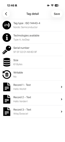

I was trying to get the NFC Sample programs to work on the nRF52840 DK but the NFC tag is not being read by my phone. The program itself is running (confimed through serial monitor output and by adding LED blinking etc). I tried both record_text and record_launch_app samples wihtout any success(I have attached the record_launch_app hex file for your testing). I tried using a OnePlus 12R as well as an iPhone 12 and the tag is not being detected by either phones.
This issues happens only on the DK. I built the same code for the Seeed Studio XIAO BLE and it works with both phones with a small handmade NFC Antenna. Can you help debug why this issue is happening? I have ruled out antenna orientation by using a multimeter to check the connectivity between antenna and DK.
