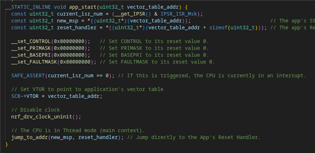

    Are you able to provide a bit more detail about the nature of the crash? If you pause the debugger, can you see where the program ends up after it crashes? Since it happens when you start using these peripherals, I’m wondering if it could be related to interrupt forwarding.
    Make the bootloader run straight to app (at 0x27000). That worked but initializing the Softdevice (present at 0x1000) made application crash. According to fora, this is not the way to go.
    It is possible to jump branch directly to the app from the bootloader but that requires the bootloader to execute the Softdevice's reset handler prior to jumping. This will not make any practical difference.
    I have noticed that our custom bootloader initializes some peripherals, that the stock BL does not use. RTC and USB for log (NOT NRF_LOG) and SPI for external flash. I have tried using the NRF_LOG, and not initialize the rtc, but that did not work.
    It’s generally good practice for the bootloader to reconfigure any peripherals it uses back to their reset state before branching to the application to ensure that the app always boots into the same known state.

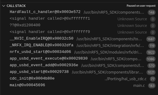

    With USB inserted:
    This is how it crashes when USB is connected.

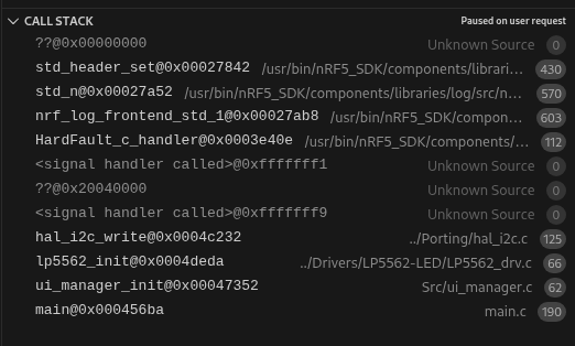

    Without USB inserted:
    Here is the call stack at the point of the crash when the device runs without USB connected.
    I’ve also tried explicitly deinitializing the peripherals used by the bootloader before jumping on. I’m calling the deinit routines for CDC (USB) and I2C once the bootloader is done using them, so they should be re-initialized cleanly by the application after the jump.
    Despite this, the crash behavior remains the same.
    For completeness: I2C is not used or initialized in the bootloader at all, so it should already be in its reset state when the application starts.
    Thanks. As you can see from the call stacks, the exception handlers are being executed at invalid addresses (0x1200400 and 0x20040000). The latter is the typical initial stack pointer value and is also the first entry in the Cortex-M vector table, which is suspicious. The issue is clearly related to interrupt handling.
    After reaching main() in the application, please read out the value at 0x20000000 and 0x20000004. These hold the interrupt forwarding address for the MBR and Softdevice respectively (expected values are: 0x1000 and 0x27000).

    And also just to confirm, the bootloader is not changing the VTOR register in this case?
