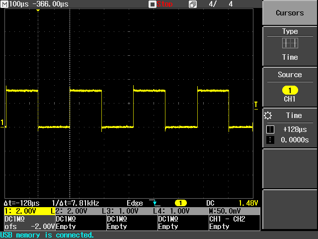

Running on Fanstel BM15M module (nrf54L15) SDK v3.1.1, I seeing a huge timing error when trying to implement a simple timer function.  In the code below, I believe I have followed the examples to implement a timer (24) with a 1MHz frequency and a 100 count interval which should yield a 10kHz interrupt. But using the callback function to toggle a debug pin and monitoring that pin with an O'scope, I see a stable 128us interval instead of 100us - a 28% error.  I am running off the internal oscillator. The internal crystal is 250ppm which should yield at most an error 2.5us
Please tell me what I am doing wrong.  Side note when I try to use the external 32MHz crystal per the notes provided by Fanstel, I get stuck with an assertion error - "err = mpsl_init(&clock_cfg, CONFIG_MPSL_LOW_PRIO_IRQN, m_assert_handl" - but that is perhaps a discussion for another day.

  • Thank you.  That addresses my issue.
    A couple follow up questions.
    I see that the output on my debug pin varies some from cycle to cycle, I assume this is related to other interrupts having priority.  I don't expect I can get around BLE interrupts, but I would like this timer to be as regular as possible.  I see in the IRQ_CONNECT marco the IRQ_PRIO_LOWEST VALUE -does this select the lowest possible the lowest priority IRQ, or does it assign the lowest available IRQ number which is the highest priority?  Do lower numbered timers has lower number IRQs by default.  Asked another way, in a system with several timers, how do I control which one has the highest priority IRQ?
    Also, I would like to resync this timer with an periodic external event (a GPIO interrupt) is nrfx_timer_clear() the correct call or is there a better way to resync the timer?  Do I need to disable the timer to clear it, or will that just cause an unwanted delay in the syncing process.
  • Forget interrupt handler, interrupt entry time is variable on ARM Cortex-M CPUs.
    Use either a timer with DPPI and GPIOTE - or use the PWM peripherial directly, depending on what you need for your application.
    Expected Interrupt jitter with BTLE enabled would be in the 100s of µs - BTLE is very timing critical and the softdevice checks this.
