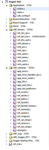

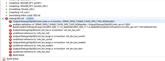

I am using this SDK version 17.1.0 as I am using ESB in this project.  So far I have gotten ESB, SPI, and UART communications working.  SPI and UART are both using easy DMA, and I was trying to get easy DMA I2C working with this project.  I am using the Segger Embedded Studio toolchain version 7.32a. I am including my sdk_config.h file and my i2cDrv.c that right now just tries to initialize my !2C bus. I am getting the following error. Nothing I am doing seems to be working.  I am also attaching the snippet that shows the pertinent files that are included in my project.

    ret_code_t err_code = nrf_twi_mngr_init(&m_twi_mngr, &twi_config);
Any ideas what I am doing wrong?  If more information is needed just let me know what you need.  Thanks
