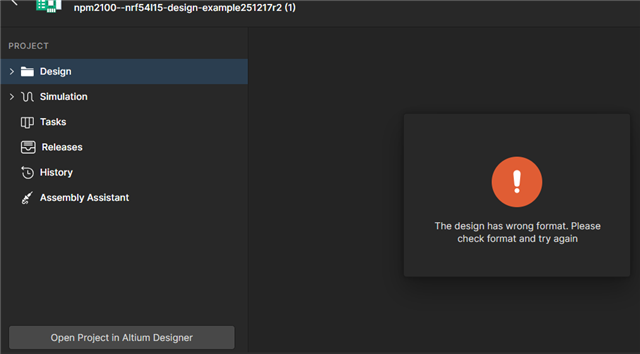

I am trying to open this in Altium and I get this error. Looks like the file is corrupted?
And Altium error is shown below.

Hi, Tilak.
Thank you for reporting this.

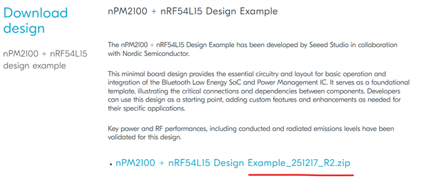

I tried downloading the files and experienced similar issues when trying to extract the files from the zip folder myself. I've forwarded your findings internally.
Could you try using 7zip to extract the files before opening them and see if this works?
Mathias
Thank you for the quick resolution. I wasn't expecting a KiCad project :) All works well. Thanks.
