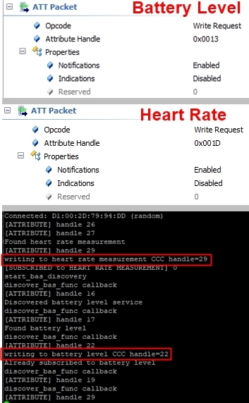

I noticed that subscribing to the HRM notifications with bt_gatt_subscribe returns 0 but when subscribing to the battery level notifications I'm getting EALREADY which according to the documentation for bt_gatt_subscribe means that notifications are already subscribed for on this characteristic.
The handle parameters for the two bt_gatt_subscribe calls are not the same, so it's not that I neglected to change the subscribe params for the second call.
writing to heart rate measurement CCC handle=29
[SUBSCRIBED to HEART RATE MEASUREMENT] 0
writing to battery level CCC handle=22
Already subscribed to battery level

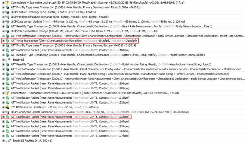

A trace confirms that only one CCC is being written to. HRM notifications are being transmitted by the peripheral.

    The attribute handle for BAS in the log (22) does not seem to match what is shown in the sniffer capture (0x12), but I I'm not immediately able to spot anything wrong from the code snippets you posted. As a test, could you please try connecting to this peripheral from the Bluetooth Low energy app in nRF connect for desktop and check the log which attribute handle is being used when enabling notifications on this characteristic?
    Vidar
  • Hi Vidar, thanks for your reply. I see what you mean about the handle value. And (great idea), the Bluetooth Low Energy app confirms that my code is not selecting the right handle for the Battery Level CCC.
    It must be a bug in my code then. I'll keep staring at it until I can see the problem :-)
  • Thank you for the update. Looking at the description again I think I may have misread the sniffer capture. With the battery characteristic declaration at handle 0x12 it seems correct to have the CCC handle at 0x16 (22). Please let me know if you are still experiencing the issue. If so, I will try to reproduce it here.
