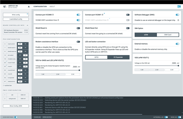

We’re trying to use UART1 on the nRF9151 DK in non-secure mode, mapped to the Arduino R1 connector. However, it seems to be reserved by TF-M, and we cannot disable TF-M because we also need LTE functionality.
We even tried disabling VCOM1 using the Board Configurator, but it didn’t help.
According to the documentation, it should be possible to free UART1 by disabling a configuration, but in our setup it doesn’t work.

    UART1 should be available to the application as long as CONFIG_TFM_LOG_LEVEL_SILENCE is selected which I see you have done already in your project configuration file.
    VCOM1 must be disabled in the board configurator app to change the routing of the UART pins from the Jlink MCU to the pin headers. Had you tested the same without TF-M and verified that it worked?

  • Hi Vidar,
    Thanks for the clarification.
    We tested again with TF-M enabled and CONFIG_TFM_LOG_LEVEL_SILENCE=y, and UART1 is indeed available to the non-secure application as expected.
    The issue turned out not to be related to TF-M or UART reservation, but rather to a host-side serial terminal problem: on macOS, minicom was not showing the UART output correctly. When testing on Ubuntu, UART1 worked fine.
    So the configuration was correct.
    Thanks again for your help!
    Federica from OWL Services.
