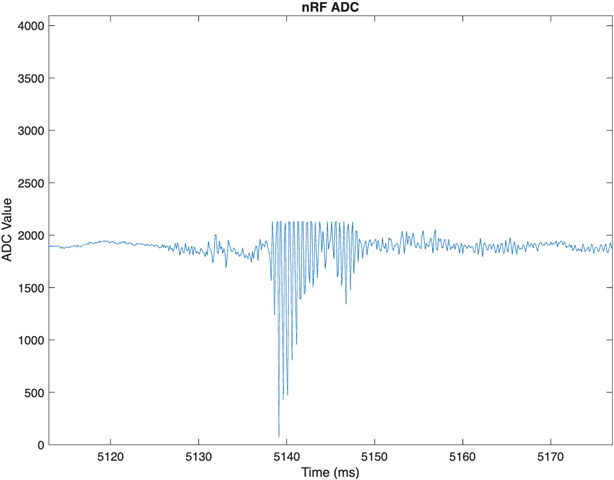

Issues measuring fast signals on the nRF54L15-DK ADC

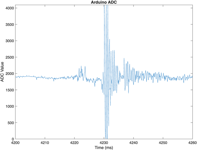

I am trying to measure a fast, impulsive signal from an amplified analog microphone using an ADC pin on the nRF54L15-DK. When I read the same signal using a 12-bit analog input on an Arduino board (ESP32 Feather V2), the waveform behaves as expected and spans nearly the full ADC range (0–4095). However, when reading the signal at 8 kHz with the SAADC on the nRF54L15-DK at 12-bit resolution, the waveform appears clipped and consistently maxes out at around ~2150 counts (see plots below).
To rule out range or reference limitations, I applied a static DC voltage to the same nRF ADC pin (approximately 3.0 V from a bench supply). In this case, the SAADC reads correctly (~3400 counts), confirming that the ADC can measure higher voltages and that the issue is specific to fast transient signals. I also swept the acquisition time from 2 µs to 40 µs, but the impulse signal still clips at ~2150 counts for all acquisition times tested.
The SAADC input is configured as single-ended with 12-bit resolution, using the internal reference and a gain of 1/4, with oversampling and burst mode disabled. The relevant ADC sampling code is included below.

Do you have any recommendations on how to fix this issue? Thanks for any help you're able to provide.
