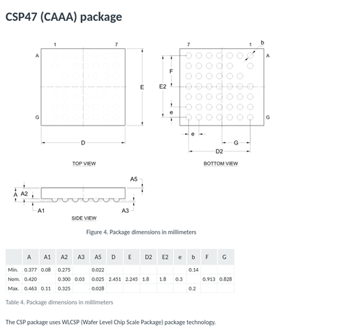

  • For the nRF9151-LACA-R, I cannot find the flatness parameter in its datasheet. Can you help confirm the flatness?
  • For the nRF54L15-CAAA, the datasheet shows A3 (0.03). Can you confirm if this refers to flatness?
    We need to confirm the stencil thickness for better SMT.
    We typically use 80um thickness for the stencil for these products.
    For the nRF91 I was not able to find a number form the datasheets, but for the nRF54L you have the A1 dimension from the datasheet.
    The A3 is referencing the coplanarity, so not sure if that is what you are after.
