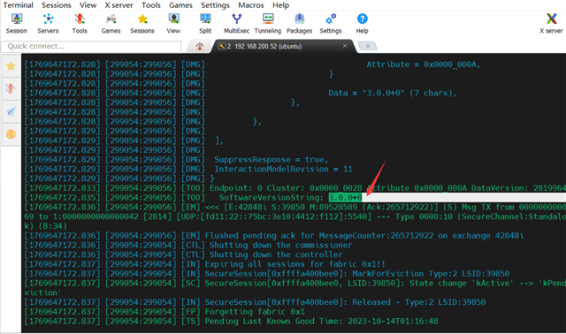

I am currently developing a Matter product using the NCS (nRF Connect SDK) version 3.1.1. During the build process, the software version string is automatically generated as 3.0.0+0.
Could you please advise on how to modify this string to display simply as 3.0.0 (removing the trailing +0)? Specifically:

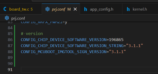

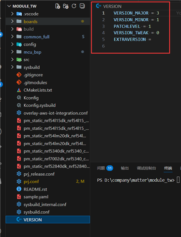

  • I referred to the instructions mentioned here that said this parameter needs to be added. I tried not adding CONFIG_MCUBOOT_IMGTOOL_SIGN_VERSION, and it didn't work. I also tried adding it, but it still didn't work. I found that adding this configuration through the prj.conf file does not actually change the version number. The version number is still determined by the configuration in the version file. How should I solve this?
