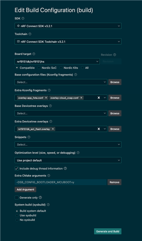

  • Modified it to use MCUBoot and Ext Flash
  • Built “Modem Shell”  with cloud_coap
Build error
  • Get error in main.c, “undefined boot_write_img_confirmed”

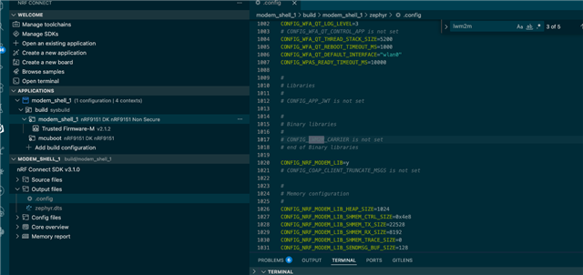

#if (defined(CONFIG_BOOTLOADER_MCUBOOT) && !defined(CONFIG_LWM2M_CARRIER))
    boot_write_img_confirmed();
Workaround
  • set “#define CONFIG_LWM2M_CARRIER = 1"
Previously with NCS 3.1.0
  • The modem_shell sample had CONFIG_LWM2M_CARRIER already enabled
  • Hence, in main.c “boot_write_img_confirmed()” was disabled correctly and build didn’t generate any error.

  • Modified modem_shell uses MCUBoot and the external FLASH of the nrf9151dk
  • Built modem shell with cloud_coap (nrf9151dk/nrf9151/ns)

Set  CONFIG_LWM2M_CARRIER as above, built Modem Shell as nrf9151dk/nrf9151/ns target
  • nrf9151dk connects to cellular network and nRF Cloud
  • Verified connectivity to nRF Cloud via “location get —method=cellular"
