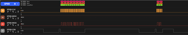

about nrf54L15 chip SPI Port on sdk3.2.1.
I used  nrf54L15 chip P2 port's SPI.used  spi_transceive_dt tx 10 bytes. but chip divide two process (8Bytes+2Bytes).this result is not my object. code as below:
int spi00_dma_transceive(const uint8_t *tx, uint8_t *rx, size_t len)
    struct spi_buf tx_buf = {
        .buf = (void *)tx,
        .len = len,
    struct spi_buf rx_buf = {
        .buf = rx,
        .len = len,
    struct spi_buf_set tx_set = {
        .buffers = &tx_buf,
        .count   = 1,
    struct spi_buf_set rx_set = {
        .buffers = &rx_buf,
        .count   = 1,
    return spi_transceive_dt(&spi00_dev, &tx_set, &rx_set);
  • and CS is not right. this pin I not used other function. this is overlay file and SPI code.

    &spi00 {
        status = "okay";
        pinctrl-0 = <&spi00_default>;
        pinctrl-1 = <&spi00_sleep>;
        // cs-gpios = <&gpio2 5 GPIO_ACTIVE_LOW>;
        rd_spi_00: rd_spi_00@0 {
            compatible = "rd-spi-device"; //compatible = "spi-device vnd,spi-device";
            reg = <0>;
            duplex = <0>;
            frame-format = <0>;
            spi-max-frequency = <8000000>;
            spi-cpha;
            //spi-cpol;
            label = "rd_spi_00";

        spi00_default: spi00_default {
            group1 {
                psels = <NRF_PSEL(SPIM_SCK, 2, 1)>,
                        <NRF_PSEL(SPIM_MOSI, 2, 2)>,//输出 SDO
                        <NRF_PSEL(SPIM_MISO, 2, 4)>,//输入 SDI
                        <NRF_PSEL(SPIM_CSN, 2, 5)>;//输入 CS
                nordic,drive-mode = <NRF_DRIVE_E0E1>;
                bias-pull-up;
                //bias-disable;

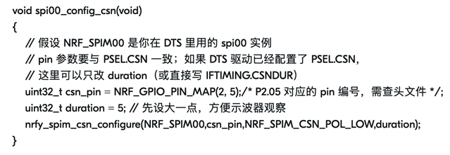

    void spi00_config_csn(void)
        // 假设 NRF_SPIM00 是你在 DTS 里用的 spi00 实例
        // pin 参数要与 PSEL.CSN 一致;如果 DTS 驱动已经配置了 PSEL.CSN,
        // 这里可以只改 duration(或直接写 IFTIMING.CSNDUR)
        uint32_t csn_pin = NRF_GPIO_PIN_MAP(2, 5);/* P2.05 对应的 pin 编号,需查头文件 */;
        uint32_t duration = 5; // 先设大一点,方便示波器观察
        nrfy_spim_csn_configure(NRF_SPIM00,csn_pin,NRF_SPIM_CSN_POL_LOW,duration);

    static int spi00_dma_init(void)
        if (!spi_is_ready_dt(&spi00_dev)) {
            printk("spi00_dev init is error\r\n");
            return API_ERR_DEV_NOT_READY;
        NRF_GPIOHSPADCTRL->BIAS = 0x03;
        spi00_config_csn();
        return RET_SUCCESS;

    /* 6. 全双工收发:spi_transceive() */
    static int spi00_dma_transceive(const uint8_t *tx, uint8_t *rx, size_t len)
            .buf = (void *)tx,
            .len = len,
            .buf = rx,
            .len = len,
            .buffers = &tx_buf,
            .count   = 1,
            .buffers = &rx_buf,
            .count   = 1,

    This is not a recommended way to configure CSN like combining zephyr driver APIs with direct nrfx/HAL/HALY calls.
    Can you please look at this dev academy course Exercise 1 - Interfacing with a sensor over SPI - Nordic Developer Academy
