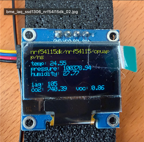

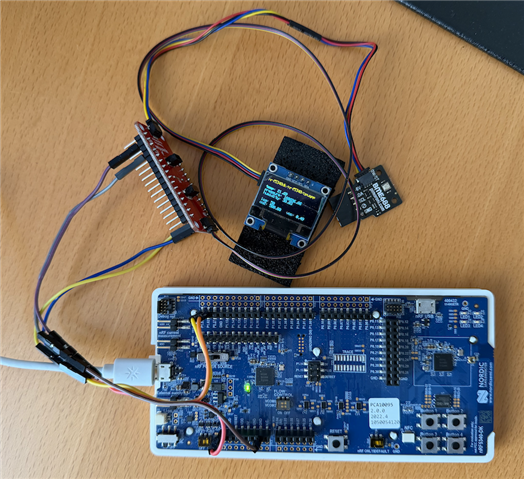

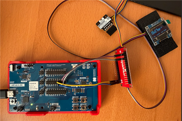

nRF54L15-DK and SSD1306 OLED setup with a Sparkfun QWICC multiplexer.

    • Sensors BME280 and BME688 were not detected on the I2C at VDD 3.3V. “Device not ready” message observed.
    • However, SSD1306 was detected correctly at 3.3V

  • Thanks. Agree regarding the need to debug the issue with a oscilloscope. Unfortunately, I don't have access to store one yet.
    I've been using the VDDIO on the nRF54L15. with 0K external pull-ups. Also, tried using the Thingy53's 3.3V from the Quick connector.
    The nRF54L155-DK does seem to be more sensitive than the other devices. I've had no issues at all when using the BME688/BME280 with  nRF5340-DK, nRF9151-DK, various nRF52840 boards or the ESP32/Raspberry Picos.

  • Hi Håkon,
    Thanks. You’ve used the Thingy53’s BME688 whereas I’m using a BME688 directly connected to the nRF54L15 and external 10KOhm pull-ups.
    It should not be such an issue to hookup a sensor to a nRF54L15-DK. The nRF5340-DK and nRF9151-DK have had no issues with the same sensors and leads. Also, no issues with using the same setup with other MCUs.
