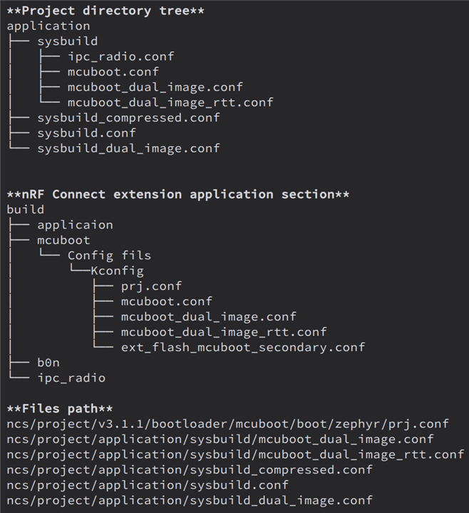

  • Hi Vidar,
    To make it easier to understand, I created a simple tree diagram of my project, as shown below:
    I've tried adding this configuration to one of the files in the Kconfig section, such as mcuboot_dual_image_rtt.conf, but the result is still the same, no change at all. Or am I misunderstanding something?
    Kevin

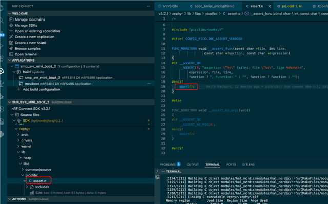

    I was looking at the assert.c implementation for for Picolib where I assume abort() is being called:
    but forgot to point out that you also need to enable asserts in this build. Is your bootloader also using Picolib? If so, please try with the following configs:
    CONFIG_ASSERT=y
    CONFIG_PICOLIBC_USE_MODULE=y
    CONFIG_PICOLIBC_ASSERT_VERBOSE=y
    Vidar
