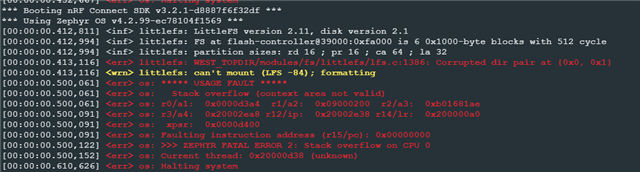

Hello Nordic team,
I am using an nRF5340 DK with Zephyr, and I am facing an issue where the UART console freezes whenever CONFIG_LOG_BACKEND_FS=y is enabled.
My logging configuration is:
# LOGGING
CONFIG_CONSOLE=y
CONFIG_UART_CONSOLE=y
CONFIG_LOG=y
CONFIG_LOG_BACKEND_UART=y
CONFIG_LOG_DEFAULT_LEVEL=3
CONFIG_PRINTK=y
CONFIG_LOG_BACKEND_FS_AUTOSTART=y
CONFIG_LOG_BACKEND_FS_FILE_SIZE=20960
CONFIG_LOG_BACKEND_FS_FILES_LIMIT=1
CONFIG_LOG_BUFFER_SIZE=8192
CONFIG_LOG_BACKEND_FS_DIR="/lfs"
With the FS backend enabled, UART output stops during runtime.
If I disable the FS backend, UART works normally.
I would like to keep FS logging enabled, so I would like to know how to configure Zephyr or the nRF5340 to avoid UART freeze when using LOG_BACKEND_FS.
In other words, what settings or best practices can ensure stable UART output while FS logging is active?
Thank you.

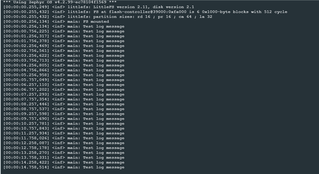

    I have run your sample on nRF5340DK. With or without this config CONFIG_LOG_BACKEND_FS=y in the prj.conf file I can get output on the UART terminal following output
    then I was now concerned about stack overflow.
    After adding these two configuration
    CONFIG_SYSTEM_WORKQUEUE_STACK_SIZE=4096
    CONFIG_MAIN_STACK_SIZE=4096
    I got the correct output.
    You can try to do that and let me know the result
    Thanks
  • Hello Kazi,
    Thank you very much for your previous suggestions regarding the stack sizes (CONFIG_SYSTEM_WORKQUEUE_STACK_SIZE and CONFIG_MAIN_STACK_SIZE). While those specific changes didn't resolve our UART freeze directly, they helped us narrow down the root cause of the issue.
    We have identified that the problem was a mismatch between the software-requested log capacity and the physical partition size defined in the devicetree.
    Our Findings:
    In our prj.conf, we initially requested a total log capacity of approximately 102.3 KB (20,960 bytes×5 files):
    # LOGGING
    CONFIG_LOG_BACKEND_FS_FILES_LIMIT=5
    However, the default storage_partition for the nRF5340 DK is only 32 KB (reg = <0xf8000 0x8000>). When we tested reducing CONFIG_LOG_BACKEND_FS_FILE_SIZE to 16384, the logs began to display correctly because the total volume fit within the physical limits.
