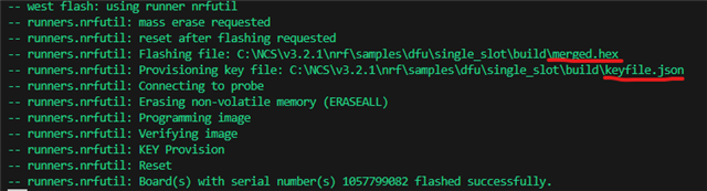

[NCS 3.2.1-SINGLE SLOT DFU] Issue with nrf54L15dk
for a project based on the nRF54L15, we are evaluating the new single-slot DFU mechanism.
Using NCS v3.2.1, I am testing the sample available at:
https://github.com/nrfconnect/sdk-nrf/tree/v3.2.1/samples/dfu/single_slot
After flashing the merged.hex file generated in the build folder, the board appears to be unresponsive. There is no output on the terminal, and the procedure to trigger the firmware loader (pressing Button 0 while resetting the board) does not seem to work.
The hardware in use is an nRF54L15 DK, revision 0.9.2.
Have you encountered a similar issue?
Alessandro
