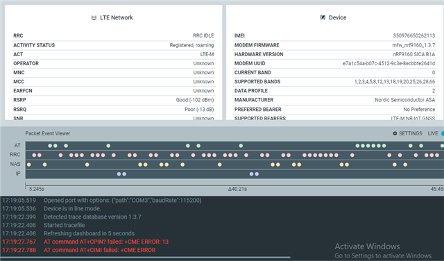

hi samruddhi,
i think i successfully add the at client file in programmer and add the LTE-M connection so i sent you a screenshot about a cellular monitor application but i don't know, is this information showing correct? and what's that error showing me in bottom of the screenshot.
thanks

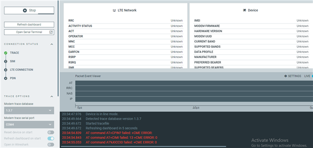

hi,
sorry to bother you but i try to connect everthing one more time from scratch like open a programmer app and add at client file and then trying to connect cellular monitor but now the cellular monitor didn't connect properly. i don't know why can you help me what's going on.
thanks

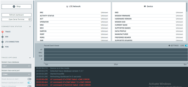

hi,
now it's trace but it won't go to the further process.

Just a quick update. One of the errors which you are receiving shows an issue with connecting to the network. Which sim card are you using? If you have recently started using the nRF9160 DK and want to learn the basics, I would also recommend you to go through the Cellular IoT Fundamentals DevAcademy course which goes through the essentials about application development and LTE-M, NB-IoT etc.
