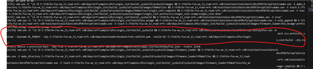

With west verbose enabled, I see that the following command is used to generate keyfile.json:
west ncs-provision upload \
  --keyname BL_PUBKEY \
  --key <path>/bootloader/mcuboot/root-ed25519.pem \
  --build-dir <path>/samples/dfu/single
