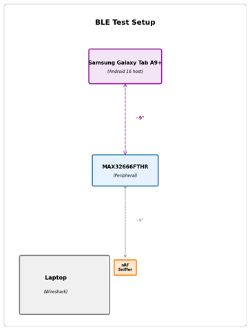

    Just FYI, here is a depiction of the test setup for the test run described above:

    Thank you for the updates. Your insights are appreciated.
    Let us check if what you have is something we can use to reproduce locally. In any case we would be able to look at the full .pcapng, so that one could be very useful, yes.
    If with the .apk we manage to reproduce the behavior you are seeing, then we may be better positioned for improving the performance of the sniffer. If you don't want to share it here in a public ticket, then please either create a private ticket and share it there, or I can turn this one private (if so then please let me know.)
    Terje
  • Hi, thank you for your reply.  One more detail I just learned this morning - disabling WiFi on the Samsung tablet stops the Anonymous advertising packets.  For sure the tablet is connecting in the 5GHz WiFi band so this is quite surprising to me.  Either way, it would be great if the sniffer could be made robust enough to weather the disruption, whatever the source.
    I will create a private ticket to upload the apps and logs.
