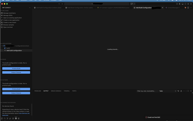

nrf connect vscode extension build configuration seems to be broken?
Hello!
It seems that updating the nrf connect vscode extension has somehow broken the ability create and modify build configuration. Tested in wsl and m4 pro.
The last working version is 2025.12.1228
Here is the generated information from the extension.
