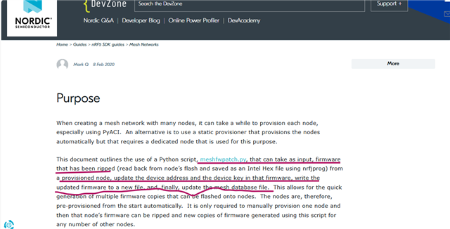

Apologies for the delay. Yes, it is possible and meshfwpatch.py supports generating provisioned firmware copies. According to the docs you provided, you provision one reference node, read its flash, then when you run meshfwpatch.py, it makes new pre-provisioned firmware images for more devices. It will update the device address and key. So, these can be flashed onto additional nodes.
