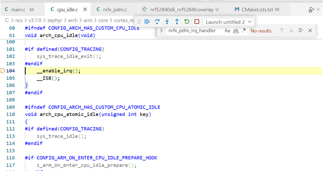

Situation 2:
However, when I comment out lines 50–57 and line 61 in main.c, the code:
  • Runs without errors
  • Flashes successfully on the nRF52840
  • But no printf output appears on the serial terminal
After debugging, I observed that the issue seems to be interrupt-related, possibly linked to the PDM peripheral.
i have uploading the screenshot , when debug the code
nrf52840_pdm_mic.zip

    This line from your build log points to the issue while building:
    C:/Users/2768/untitled/src/main.c:52: undefined reference to `nrfx_pdm_irq_handler'
    The build system expects an instance to be specified. I resolved the build error by specifying nrfx_pdm_0_irq_handler on line #52 in main.c
    Situation 2:
    In the prj.conf printf is configured to appear on RTT and not the serial terminal. Do you also get no RTT output?
