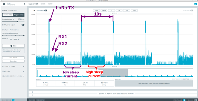

My problem is that after sending data through LoRa, the sleep current stays around 400uA for an indeterminate amount of time before dropping back to the pre LoRa sleep current, which is around 7uA.
The goal is to reliably and deterministically force the system to deep sleep after the LoRa transmission is complete.
So my question is: What could be causing this and how do I fix it?

Here is a screenshot illustrating the behavior:

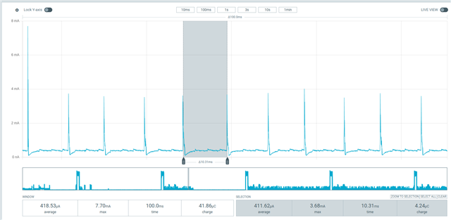

  • Hi Kenneth,
    Thank you for your reply.
    It does look like a timer is causing this, or rather it looks like something wakes up periodically.
    When I zoom in, we can see that the 400uA average current is caused by these periodic spikes.
    I've been testing a bit and the spikes don't always happen at the same frequency. Most often, I've observed a period of 10ms, but I've also seen 20ms, 3ms and around 2.3ms. Interestingly, the average current is always around 400uA.
    I have disabled everything else (including logging) to rule out other factors, even if the high sleep current only occurs after a Lora transmission anyways.
    I have tried disabling the RTC timers, the High Frequency Clock and the Low Frequency Clock. This only broke the ability of the nRF to wake up again, but the high average current after LoRa remained.
    Do you have any insights here? Is there a way to check which timers are in use or a way to simply kill all timers that could be in use?
    Regarding you second suggestion: I did find the SX126xSetSleep() function but calling it seems to have no effect on the sleep current.
    Lukas
