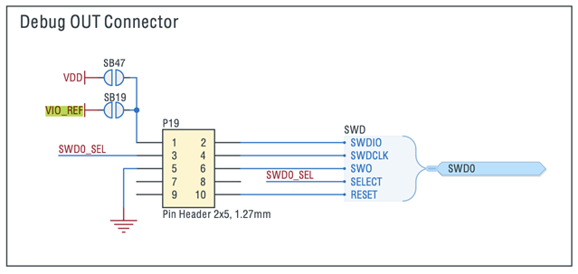

I’m looking to program an external device that runs on 3.3V with my NRF52840 DK (v3.0.1), and I’m looking to verify that this is possible. I know that the DK runs at 3.0V.
If I would like to achieve this through the P19/Debug OUT Connector, should I bridge SB19 and leave SB47 open? I am planning to power the device separately from the DK. Please let me know if I am on the right track with this approach, thank you!
