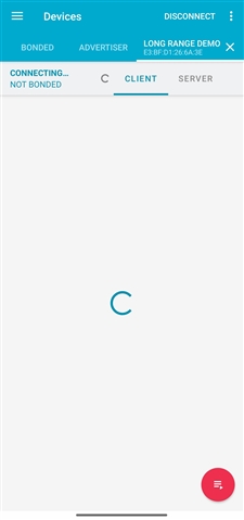

    Long range demo example (downloaded from github.com/.../nRF52-ble-long-range-demo) with nRF52840 EVK: We are not able to connect most of mobiles like iPhone v26.2.1, Android 15(POCO, IQOO), Android 16(realme) and tried with by toggling between Coded PHY, 1M PHY using button1 and between 0dbm, 8dbm using button2.

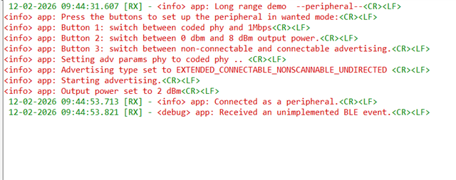

    'Received an unimplemented BLE event' on UART when facing connection issue from above listed phones. We are getting advertisements on all Android15, Android 16, iPhone phones with long range demo also.
    Log and phone image are attached for your reference.

    Received an unimplemented BLE event: the value of p_ble_evt->header.evt_id is 0x0023
    Even after changing the code nRF5 SDK 17.1.0 the result is same, it is not connecting to android 15 mobiles with in 1M PHY.
    I see. 0x0023 is BLE_GAP_EVT_DATA_LENGTH_UPDATE_REQUEST:
      BLE_GAP_EVT_DATA_LENGTH_UPDATE_REQUEST = BLE_GAP_EVT_BASE + 19,   /**< Data Length Update Request.                     \n Reply with @ref sd_ble_gap_data_length_update. \n See @ref ble_gap_evt_data_length_update_request_t. */
    (As BLE_GAP_EVT_BASE is 0x10).
    That should be handled. I would recommend not using the demo you have found as that is outdated, and instead using another sample that is more current. This post shows how you can adapt a sample from SDK 17 to connect on coded PHY. This same will work on SDK 17.1.0. I would recommend nRF Connect SDK, though.
