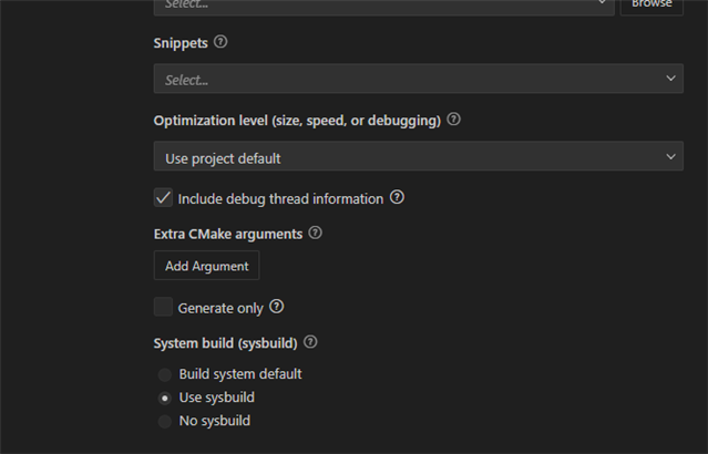

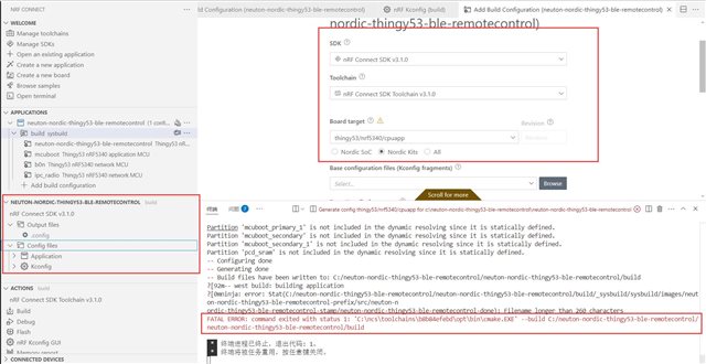

nRF Edge AI Nordic Thingy:53 Gesture Based BLE Remote Control Device Build Fail
I tried to compile the project according to the link(https://github.com/nordicsemi-neuton/nrf-edgeai-thingy53-ble-remotecontrol), but the compilation failed.
The compilation result is shown in the image below. What could be the reason for this?

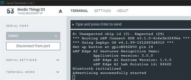

    I am not entirely sure about this sample, but I tried building and running it on my side and it works fine. I’m attaching the build log, and I can see the serial device logs also the device is advertising properly. I haven’t made any changes to the sample from the repository.
    I recommend building a sample directly from the SDK to check whether the issue is related to your SDK or toolchain setup. Are you using the default build system option in the “Add Build Configuration”? I would suggest trying it with sysbuild instead of default build config, please see my screenshot below.
    Executing task: nRF Connect: Generate config thingy53/nrf5340/cpuapp for c:\ncs\nrf-edgeai-thingy53-ble-remotecontrol
    Building nrf-edgeai-thingy53-ble-remotecontrol
    west build --build-dir c:/ncs/nrf-edgeai-thingy53-ble-remotecontrol/build c:/ncs/nrf-edgeai-thingy53-ble-remotecontrol --pristine --board thingy53/nrf5340/cpuapp --sysbuild -- -DCONFIG_DEBUG_THREAD_INFO=y
