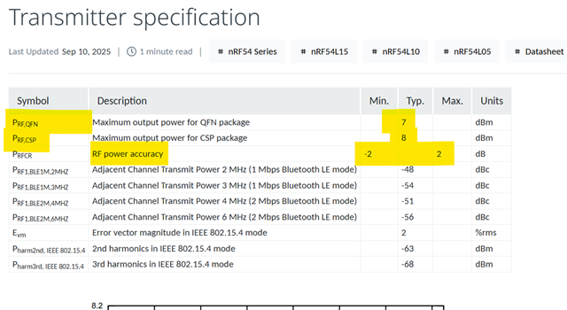

I am using the DTM example routine of NCS 3.2.1 and am currently testing the combination of nRF54L15 DK and nRF21540 EK. After flashing the original example routine to the nRF54L15 (with the nRF21540 not connected yet), I set the TP (Transmit Power) to 0 dBm via the DTM 3.1.0 application, and the spectrum analyzer detected an output power of approximately 0 dBm from the nRF54L15. However, after I added the nRF21540 configuration in the overlay file, the output power dropped to approximately -10 dBm(with the nRF21540 not connected yet),. Could this be caused by an incorrect configuration somewhere?

  • Output power from the SoC will be reduced when you add a FEM into the system. This as the output power will be SoC power + FEM gain. Add the FEM and test again.
    As Paal mentioned, when you enable FEM, the requested output power will be present at FEM output (antenna port), so the power needs to be checked after FEM when you enable FEM in your configuration.

    Thank you for your reply. I have added the ant_sel pin in the Device Tree. How can I control this pin? Are the other pins automatically handled at runtime?
    Why does adding the FEM reduce the transmit power, and what is the purpose of this?I set the TX power of the nRF54 to 0 dBm in the DTM app, but the output power via the nRF21540 is only -8 dBm. VDD 3.0V

    2、Why does adding the FEM reduce the transmit power, and what is the purpose of this?I set the TX power of the nRF54 to 0 dBm in the DTM app, but the output power via the nRF21540 is only -8 dBm. VDD 3.0V
    Because when FEM is enabled, the power you set is meant to be present at FEM output. So the power you set in DTM is equal to "SoC power + FEM gain", based on that if you set 0 dBm and the FEM gain is 10 dB , then the SoC output power would be -10 dBm. (FEM out = SoC power + FEM gain)
    So it is doing what it is supposed to do.
    Regarding the pins, tx-en-gpios, rx-en-gpios, and pdn-gpios are controlled automatically by the MPSL FEM driver when the nrf_radio_fem node and CONFIG_MPSL_FEM_NRF21540_GPIO are enabled. These pins are mandatory for GPIO mode operation.
    Regarding the other two GPIOs, mode-gpios and ant-sel-gpios are optional pins. They are also managed by the FEM driver according to the configured gain and antenna selection logic.
    If you enable CONFIG_MPSL_FEM_NRF21540_RUNTIME_PA_GAIN_CONTROL=y, the driver will toggle the MODE pin at runtime to select between the two calibrated gains (default 20 dB and 10 dB).
    If you see lower than expected power at FEM out, then it means the FEM connection to SoC is not correct. When connecting FEM to SoC, make sure the GPIOs are connected according to your selected GPIOs in the code.
