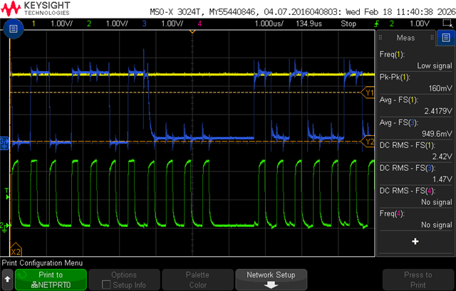

These are our Connections from P19 DEBUG_OUT to our external board:
  • Power Supply 2.5V to SWDO_VTG and to our board's BLE VDD.
  • GND to Ground
  • SWDO_SWDIO to SWDIO
  • SWDO_SELECT to Ground
  • SWDO_SWDCLK to SWDCLK
  • SWD0_SW0  Not Used
  • SWDO_RESET  Not Used
Is the RESET connection required now? Because on nRF52 devices, Reset would break the programming. What must we do to enable the SWD? What J-LINK Settings should we use on the Programmer GUI?

    The RESET pin is not required but you must make sure it is stable during programming. The connections you have between DK and your custom board is fine. Also since you can program DK BLE SoC then it means the issue is mainly from hardware not software settings or version. One common issue when using DK for programming external boards is having long wires which gives exactly similar behavior. So based on that may I know the lengths of the wires used for connections?  Please make sure the wires for connecting external board to DK is as short as possible (less than 10 cm).

  • Thanks Ressa, these are helpful hints, but we are using a probe station to connect the external board - the programming signals need to go through manual manipulators and can only be shortened so much. Is it possible to reduce the comm rate for this situation?
  • No, this is a physical limitation with the drivers on the DK. For longer cables you will probably need to use a dedicated debugger with different driver stage for the lines.

    As Paal mentioned, the standard approach in your scenario would be to have some sort of driver/buffer for the lines or to use different debugger than DK debug out port. Also if the voltage on the boards are different, then having even shorter cable is recommended when using DK debug out port.

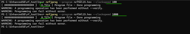

  • Just as an experiment, you can try to paly with SWD clock speed using nrfjprog command. It is not a recommended approach but you can try to see if it makes any difference:

    We looked at the SWD signals with a scope. The signals are not 'weak', but do meet voltage levels. However they are both under-damped (I/O - blue), and over-damped (CLK - green). No wonder the cable needs to be so short. The drivers need to be re-engineered.
