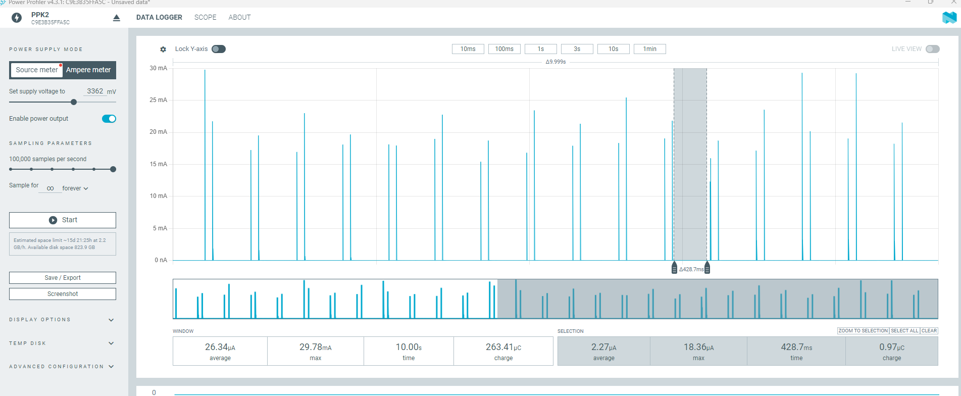

Everything works correctly. The current consumption is extremely low (around 1 µA avarage current) between communication intervals. See image attached
At this point, I simply added CONFIG_PM_DEVICE=y to prj.conf, and the current consumption immediately increased to more than 22 µA.
My conclusion is that there may be some incompatibility between CONFIG_NRF_SW_LPUART and CONFIG_PM_DEVICE. Can you confirm it?

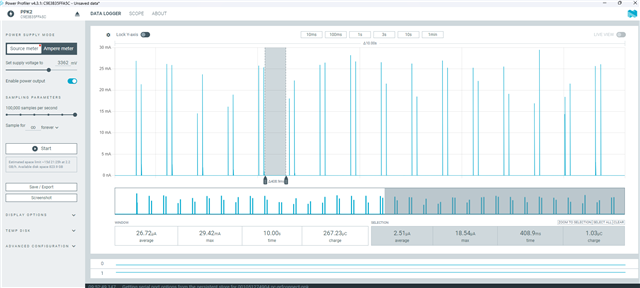

    I tried updating to SDK 3.2.2 and compiling the related lpuart example, but I don't see any changes from before. The example compiled with SDK 2.9.0 and SDK 3.2.2 give the same results and the same power consumption. I'll provide you with the diagrams again for the cases with CONFIG_PM_DEVICE set to y and n.
    I'm also attaching the new code for the lpuart example for SDK 3.2.2.
    Perhaps, are there other CONFIG to enable the configuration to avoid this behaviour?
    Thank you
    Luca

    I have run your sample on NCS v3.2.2 and I got almost same current by setting and unsetting the CONFIG_PM_DEVICE
    config_pm_device=y
    config_pm_device=n
  • Hi Kazi,
    It's so strange. I'm repeating the same test again and again, but my result is the same. With CONFIG_PM_DEVICE=y, I see a current consumption of about 23 uA. Are you sure you did a pristine buld after changing CONFIG_PM_DEVICE to y?
