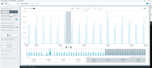

With both configurations enabled, I measure a current consumption of approximately 30 µA, while I would expect something closer to 8 µA.
My test
To further investigate the issue, I built and ran the LPUART sample on the nRF9151DK development board.
I created the files nrf9151dk_nrf9151_ns.overlay and nrf9151dk_nrf9151_ns.conf, adapting them from the nRF9160 versions.
I shorted RX and TX (pins 10 and 11), and REQ and RDY (pins 12 and 13 in my configuration), as suggested in the sample documentation.

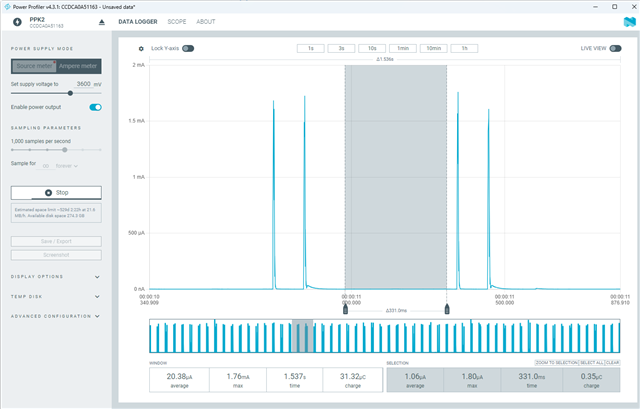

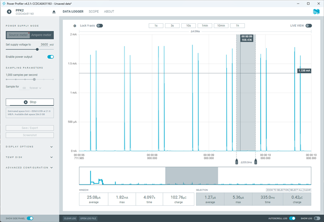

Everything works correctly. The current consumption is extremely low (around 1 µA avarage current) between communication intervals. See image attached

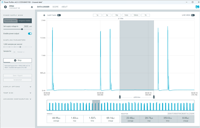

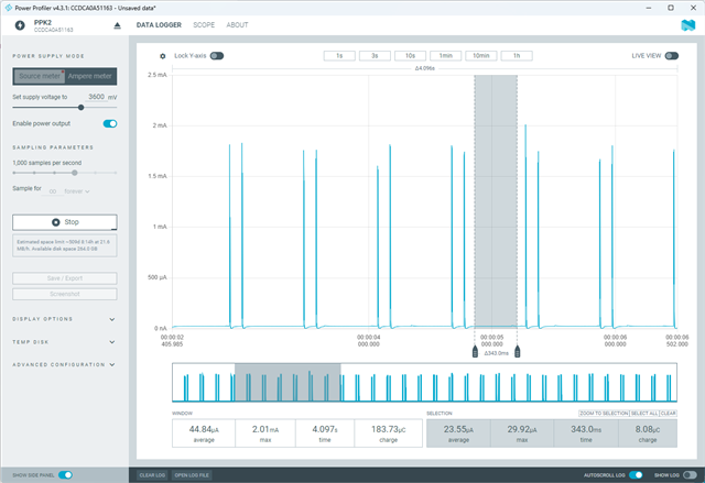

At this point, I simply added CONFIG_PM_DEVICE=y to prj.conf, and the current consumption immediately increased to more than 22 µA.
My conclusion is that there may be some incompatibility between CONFIG_NRF_SW_LPUART and CONFIG_PM_DEVICE. Can you confirm it?
