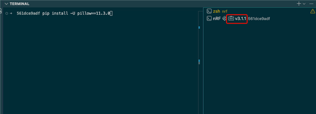

Build error during 'west flash --erase' within nRF Connect terminal of VSCode on MacOS
I am encountering a build error while setting up a build environment.
Can you provide assistance as to what the issue I am encountering may be?
I am using VSCode on MacOS Tahoe Lake to build and flash a BM15C module.
The SDK/toolchain is set to nRF Connect SDK 3.1.1.
The board target is set to nrf54l15dk/nrf54l15/cpuapp.
The system build is set to use sysbuild.
When using the nRF Connect terminal and the 'west flash --erase' command, this is the output (indented):
Working directory: /Users/davidsnelling/Workspace/fw-Gen2_Locks/build
SDK: nRF Connect SDK v3.1.1
Toolchain: nRF Connect SDK Toolchain v3.1.1

    The error seems to be that the python package "Pillow" (needed for creating the QR code) relies on a specific version of the libtiff library that is not available on your system. Please try to either switch to toolchain v.3.2.1 and build with that, or update Pillow from version 10.3.0 to 11.3.0 in your current toolchain (11.3.0 is the version used in toolchain v3.2.1).
    To update the python module in the toolchain you can open the "nrf connect" terminal in VS code (make sure the correct toolchain version is selected", then run "pip install pillow==11.3.0"
    Vidar
    Vidar
