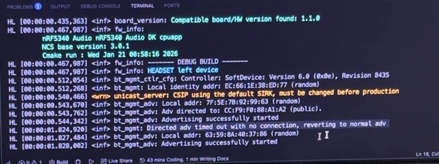

Whenever we flash the audio application (from the official samples provided) on a development board and leave the board unpowered/unattended for 10-15 days, the bluetooth advertisement messes up and doesn't let us connect any mobile device to the board. Precisely, right after powering the board, we get a message saying "Directed adv timed out with no connection, reverting to normal adv" in the RTT logs. This does not let us connect/pair any mobile device to the board. The quickest way to fix this is to simply re-flash the same audio application and it works perfectly fine. After re-flashing, we don't get the "Directed adv timed out..." error again and the board connects smoothly to the mobile device.

Below is an image showing the logs after connecting the Audio DK (see the third last line for the unusual error)
Logs after connecting the Audio DK
