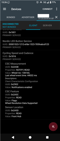

BLE CSCS - works in nrfconnect and nothing else
Exhausted everything.
Here's the guts of the code. A task is called at 2Hz to push the value, which at 1024/s makes an event time of +512. I set the cumulative RPM to +1 for testing. Both values appear correctly in the nrfConnect App. Only RPM is supported.
However, osmand shows a much higher RPM, Wahoo app shows zero. Garmin won't connect/bond. Tried a few more and nothing is working.

  • So let's break this down as I'm not agreeing. I'm only sending RPM so looking at the encoded payload is the following
    static uint8_t encoded_csc_meas[] = {1,0,0,0,0,0,0};
    The first byte is the flags field. www.bluetooth.com/.../index-en.html
    Which according to this specification the first bit indicates wheel revolutions is supported, that's what 1 is. The next 32 and 16 bit spaces are for cumulative and last event which in my case is fixed. If crank bit is not set then the additional bytes are not set or sent.

  • I have it
      if (rpm) {
        lastWheelEventTime += (1024*60)/rpm;
        cumulativeRPM++;
