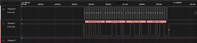

    transmission from renesas  mcu(master) is working
    but receiving end something missing.
    logs.
    00:00:49.113,372] <err> os: ***** USAGE FAULT *****
    [00:00:49.113,372] <err> os:   Illegal use of the EPSR
    [00:00:49.113,403] <err> os: r0/a1:  0x20000000  r1/a2:  0x2000122d  r2/a3:  0x00000003
    [00:00:49.113,433] <err> os: r3/a4:  0x00000000 r12/ip:  0xd04ae020 r14/lr:  0x00005ff7
    [00:00:49.113,433] <err> os:  xpsr:  0x60000019
    [00:00:49.113,464] <err> os: Faulting instruction address (r15/pc): 0x00000000
    [00:00:49.113,494] <err> os: >>> ZEPHYR FATAL ERROR 35: Unknown error on CPU 0
    [00:00:49.113,494] <err> os: Fault during interrupt handling
    [00:00:49.113,525] <err> os: Current thread: 0x20000678 (idle)
    [00:00:49.306,213] <err> os: Halting system
      this is the waveforms

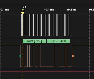

  • i tried with your suggestion and face this issue. where data is not receiving by nrf5340 i2c target
    log
    *** Booting nRF Connect SDK v3.2.1-d8887f6f32df ***
    *** Using Zephyr OS v4.2.99-ec78104f1569 ***
    i2c custom target sample
    r0/a1:  0x200019e4  r1/a2:  0x20000cbb  r2/a3:  0x00000001
    r3/a4:  0x00000000 r12/ip:  0xc5c9c6ed r14/lr:  0x00002e19
     xpsr:  0x60000019
    logic analyzer

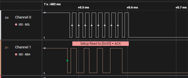

    I've used the "custom_target" sample as a base for my small sample.
    I first encountered the same issue you had with the hard fault. However, this is because the sample used is not configured to use the config "CONFIG_I2C_TARGET_BUFFER_MODE" which is enabled by default. The result is that when the i2c receive a request, it tries to call a callback which is not implemented. Thus provoke a hard fault in the MCU.
    To fix that, we either need to deactivate that configuration or to implement these callbacks. I choose to implement the callbacks as it is preferable to use the "buffer mode".
    Here is the resulting code (I tried on a nrf54l15 so the nrf5340 overlay hasn't been tested):

  • hi,
    still im facing same problem, data writing from master to slave is working fine
    but when master(controller) trying to read data from slave, slave is not sending data on bus.
    during reading from slave,  just address + ack bit is coming. data is missing
    i tried with both method
    buffer method and non-buffer method. both method giving same result
    Do you still get the hard-fault ? Can you show me the full logs, to see if they are the exact same?
    Have you updated the main.c, the prj.conf and the nrf5340dk_nrf5340_cpuapp.overlay with the code that I sent you?
    It sounds strange that it still happens, because I tried the reading and writing on this sample, and it worked on my end... Can you maybe also show me the firmware that you use as a master ?
    Simon D-M
  • Hey Simon D-M,
    Thank you very much for your help.
    I managed to fix the I2C master transmit and receive issue. The problem was actually coming from the code snippet below:
    static int sample_target_buf_read_requested_cb(struct i2c_target_config *config,
                                                   uint8_t **data, uint32_t *size)
        // printk("sample target buffer read requested\n");
        // static uint8_t buffer[1] = {0x44};
        *data = rx_buf;
        *size = sizeof(rx_buf);
        return 0;
    When these two lines were enabled:
    they introduced a small delay. Since this function is executed inside a callback context, the delay was not acceptable and the I2C read operation was failing.
    After commenting out these lines, the code works perfectly and the I2C master can now transmit and receive data correctly.
    Thanks again for your support!
