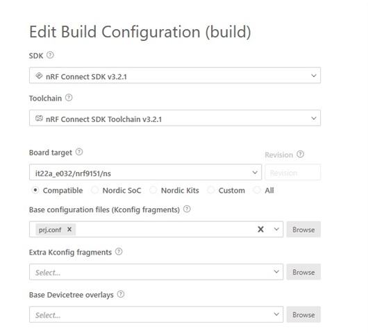

    My board settings are as follows:
    Board image
    The following operation failed:  (The hex file is not updated.)
    Build operation
    This is successful. (The hex file is updated.)
    Pristine action
    There is no error message in either case.
    Kato.
    Your board target seems fine. Normally, if you have made any changes to the board target or proj.conf, you would use pristine build to rebuild from scratch which ensures there are no errors or cached files. If the merged.hex is created by using "pristine build" but not "build", this may be caused by a fault during the build configuration. There are a couple of things, I would recommend you to check:
