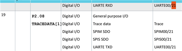

We're using UARTE21, and the board has UART_RX into P2.07/SWO and UART_TX into P2.08
  • You are using pins across power domains. Either use UART00 or use pins from Port 1.
    See Figure 1 in Product overview (datasheet), which shows power domains for peripherials and GPIO ports.
  • Hi, thank you for the reply.  Switching to UART00 seems to have resolved the issue.  Some follow up questions:
    - We used Table 73 in the datasheet to help us pick the peripherals and the table indicated that UARTE 21 is valid for P2 pins 7 and 8.  Can you point us to where in the datasheet we can find information that we are crossing power domains by using UART21 on port 2 pins?  This way, we can check if there are other irregularities.
    - Is there a tool that we can use to help check pin to peripheral mapping?  Other vendors I've used in the past has GUI tools that help generate configuration files.
