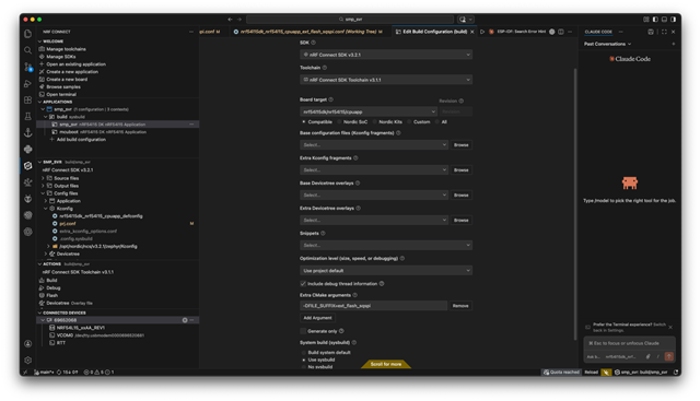

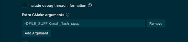

I’m seeing a build failure after enabling SQSPI in the device tree when building with MCUBoot on NCS v3.2.1 for nRF54L15.
The build works fine without SQSPI, but once it’s enabled the link step fails.

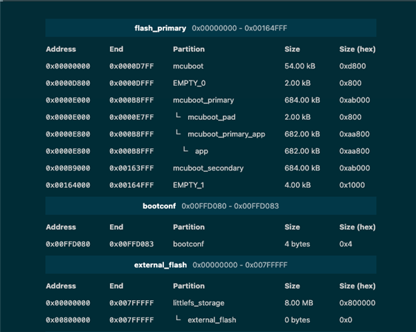

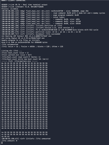

Parents Reply
  • Hi Vidar,
    I got tied up with other work over the past two weeks.
    The sample you shared doesn’t seem to match the scenario I’m encountering. My OTA implementationis based on BLE SMP service.
    If you happen to have a sample for OTA over BLE where SQSPI is implemented, could you please share it? That would likely be faster than me building a minimal example from scratch to reproduce the issue.
