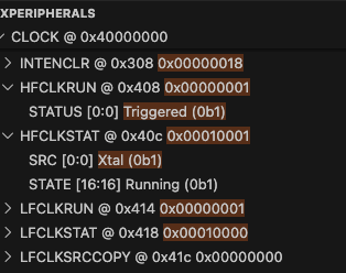

I read the docs, and I see HFCLK needs to be on. I enable it like this at wake up
    nrf_drv_clock_init();
    nrf_drv_clock_hfclk_request(NULL);
    while (!nrf_drv_clock_hfclk_is_running())
I confirm HFHCLK is running with SRC RC and STATE = 1 (running)
However when I try to call nrf_power_pofcon_set I am getting a hard fault.

  • Thanks Hung.
    Based on your advice I saw nrf_drv_power.c has support for using pof with softdevice.
    I added that, and configured.
        nrf_drv_power_pofwarn_config_t config = {
            .handler  = pof_handler,
            .thr = NRF_POWER_POFTHR_V27
        nrf_drv_power_pof_init(&config);
    I was able to get the pof_handler to fire today, how ever I see in only supports 2.7v, 2.5v, 2.3v, 2.1v via nrf_drv_power.c, and I want to use 2.8v , so I think I'm going to pull all of this into my own application and stop using nrf_drv_power.c
